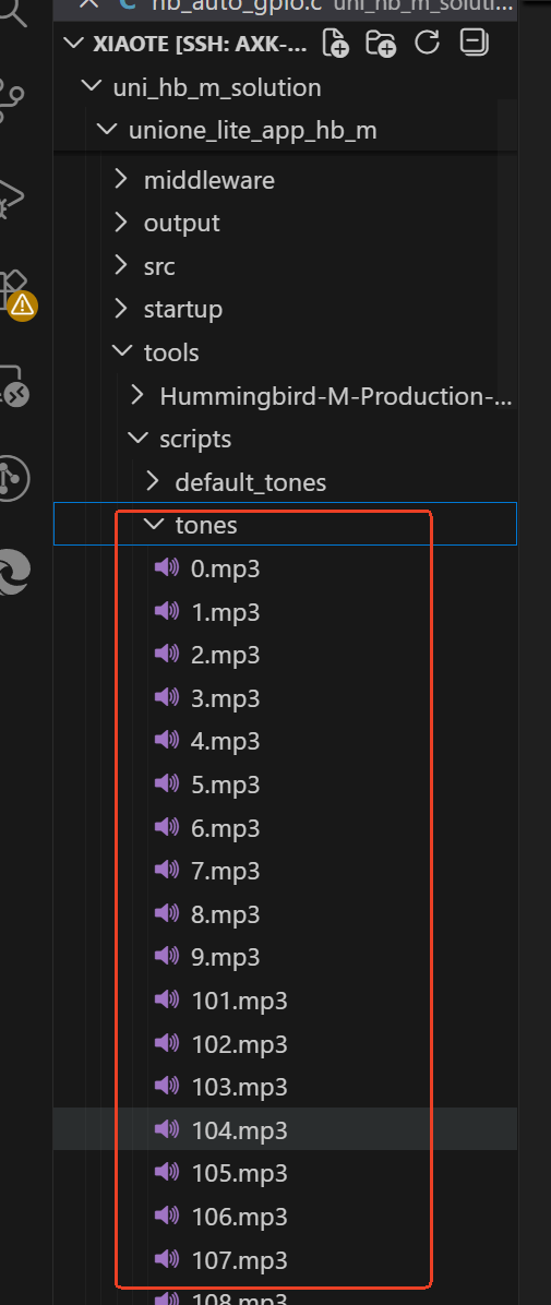

The playable audio files should not only be in 16kHz mono format but also have a depth of 16 bits. It is recommended to use Format Factory for conversion. Additionally, you can replace the corresponding MP3 files in the directory: replace/uni_hb_m_solution/unione_lite_app_hb_m/tools/scripts/tones. Other unused files do not need to be replaced.

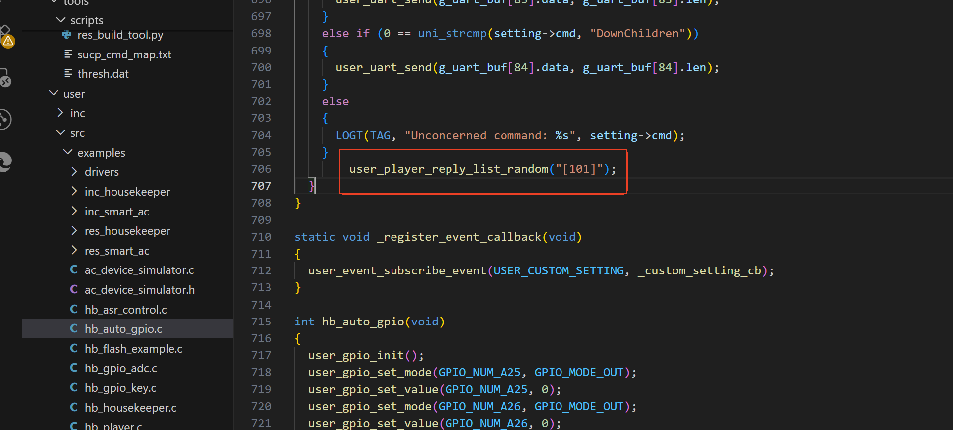

Replace the MP3 files in the "uni_hb_m_solution/unione_lite_app_hb_m/tools/scripts/tones" folder, and then use "user_player_reply_list_random" to play the corresponding MP3 files.
