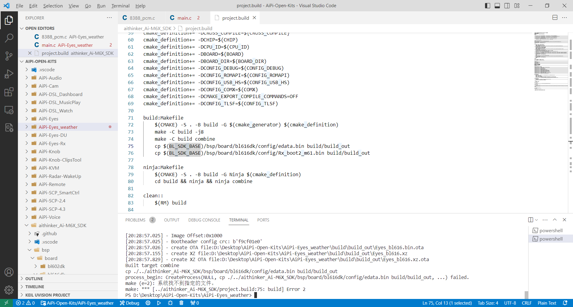

cp ./../aithinker_Ai-M6X_SDK/bsp/board/bl616dk/config/edata.bin build/build_out
process_begin: CreateProcess(NULL, cp ./../aithinker_Ai-M6X_SDK/bsp/board/bl616dk/config/edata.bin build/build_out, ...) failed.
make (e=2): 系统找不到指定的文件。
make: *** [../aithinker_Ai-M6X_SDK/project.build:75: build] Error 2
