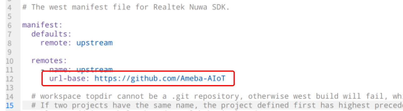

git clone https://github.com/Ameba-AIoT/nuwa.git
得到west.yml
然后修改west.yml内容:
原来url-base是git@github.com:Ameba-AIoT/nuwa.git
$ west init -l nuwa
nuwa为west.yml所在目录

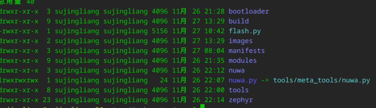

$ west update
$ ln -sf tools/meta_tools/nuwa.py nuwa.py
$ ./nuwa.py setup
最后得到:

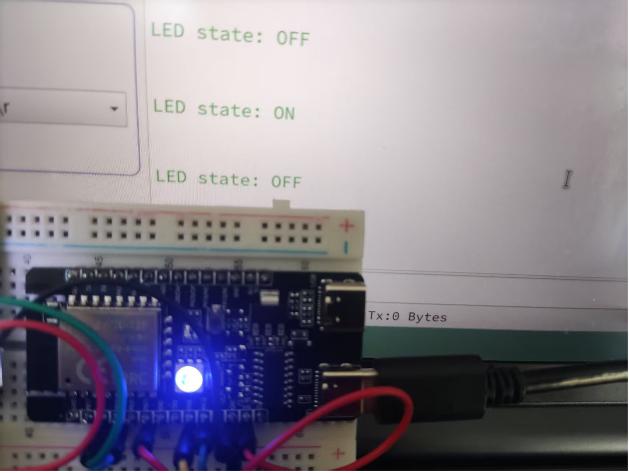

  • Copyright (c) 2016 Intel Corporation
  • SPDX-License-Identifier: Apache-2.0
#include <stdio.h>
#include <zephyr/kernel.h>
#include <zephyr/drivers/gpio.h>
/* 1000 msec = 1 sec */
#define SLEEP_TIME_MS 1000
/* The devicetree node identifier for the "led0" alias. /
#define LED0_NODE DT_ALIAS(led0)
  • A build error on this line means your board is unsupported.
  • See the sample documentation for information on how to fix this.
    static const struct gpio_dt_spec led = GPIO_DT_SPEC_GET(LED0_NODE, gpios);
int main(void)
int ret;
bool led_state = true;
if (!gpio_is_ready_dt(&led)) {
	return 0;
ret = gpio_pin_configure_dt(&led, GPIO_OUTPUT_ACTIVE);
if (ret < 0) {
	return 0;
while (1) {
	ret = gpio_pin_toggle_dt(&led);
	if (ret < 0) {
		return 0;
	led_state = !led_state;
	printf("LED state: %s\n", led_state ? "ON" : "OFF");
	k_msleep(SLEEP_TIME_MS);
return 0;
