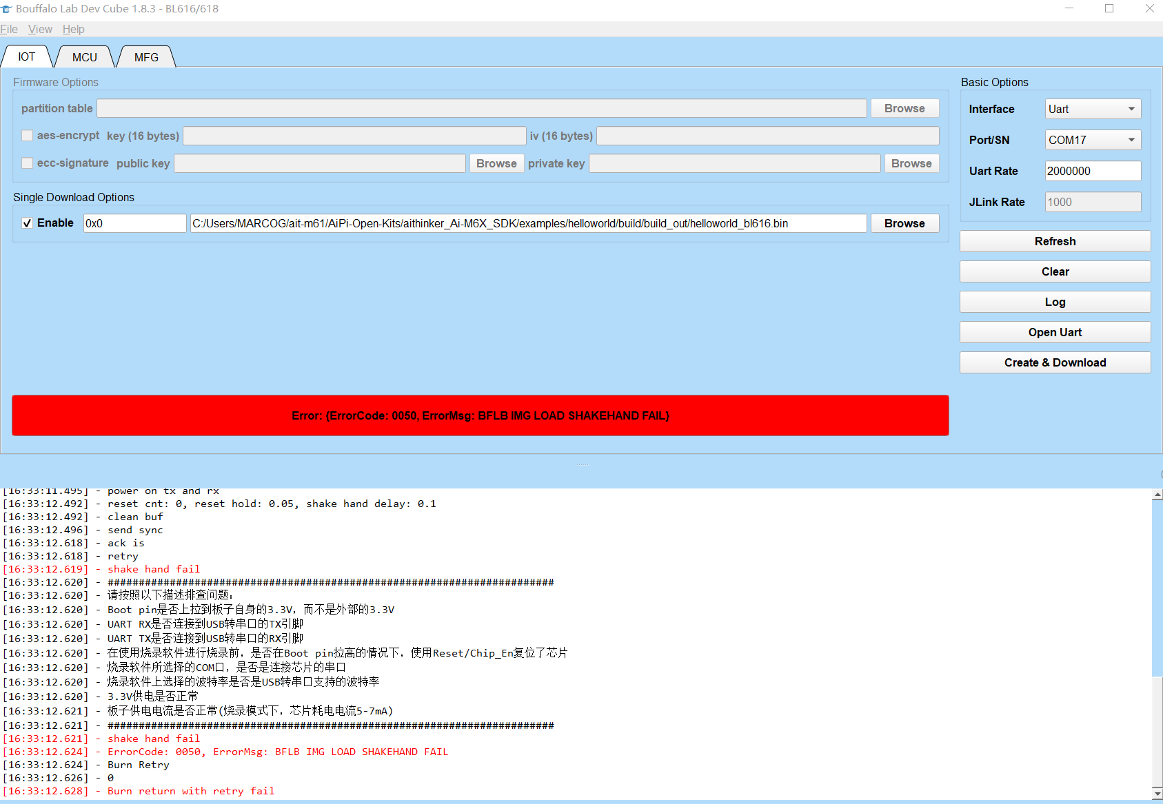

烧录的配置文件 flash_prog_cfg.ini如下:
[cfg]
# 0: no erase, 1:programmed section erase, 2: chip erase
erase = 1
# skip mode set first para is skip addr, second para is skip len, multi-segment region with ; separated
skip_mode = 0x0, 0x0
# 0: not use isp mode, #1: isp mode
boot2_isp_mode = 1
[FW]
filedir = ./build/build_out/helloworld_$(CHIPNAME).bin
address = 0x000000
2023-11-27 14:52:19
要不要试一下芯片的烧录软件
2023-11-27 16:34:10
qwe2079282957 发表于 2023-11-27 14:52
要不要试一下芯片的烧录软件
一样的
