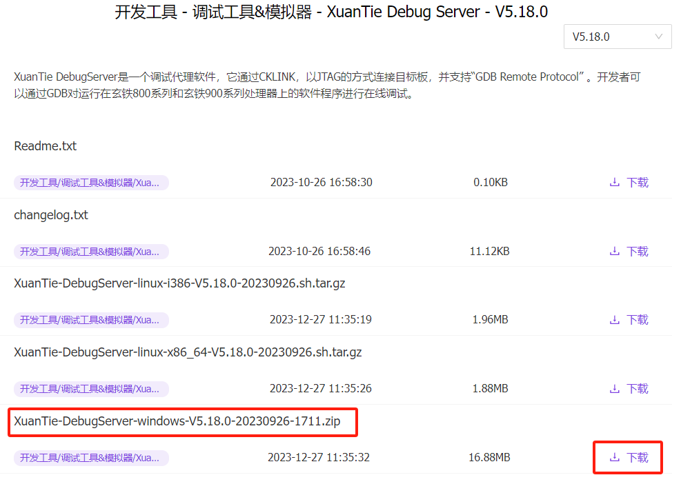

首先安装驱动
https://www.xrvm.cn/community/download?id=4238019891233361920[image.png]()
