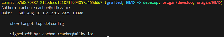

git clone https://github.com/milkv-duo/duo-buildroot-sdk-v2.git --depth=1

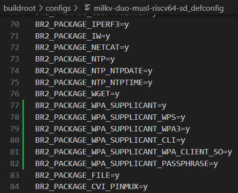

修改buildroot/configs/milkv-duo-musl-riscv64-sd_defconfig,增加WPA_SUPPLICANT选项
BR2_PACKAGE_WPA_SUPPLICANT=y
BR2_PACKAGE_WPA_SUPPLICANT_WPS=y
BR2_PACKAGE_WPA_SUPPLICANT_WPA3=y
BR2_PACKAGE_WPA_SUPPLICANT_CLI=y
BR2_PACKAGE_WPA_SUPPLICANT_WPA_CLIENT_SO=y
BR2_PACKAGE_WPA_SUPPLICANT_PASSPHRASE=y

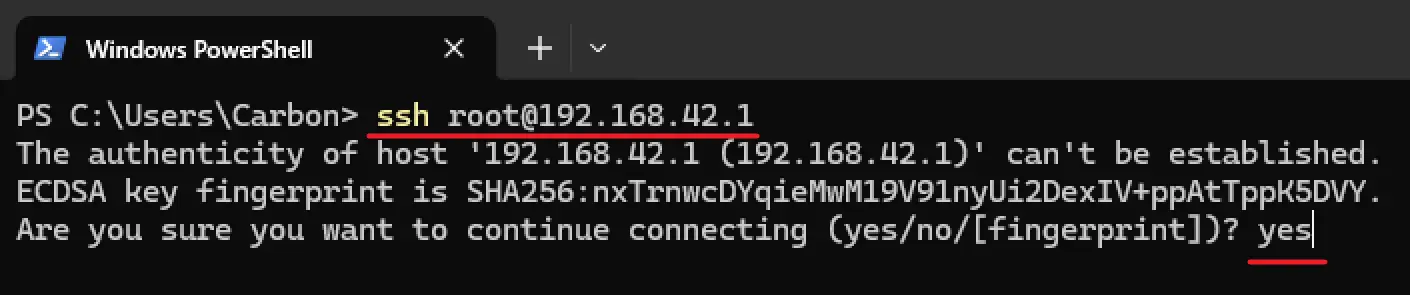

ssh连接开发板,ssh root@192.168.42.1,初始密码:milkv

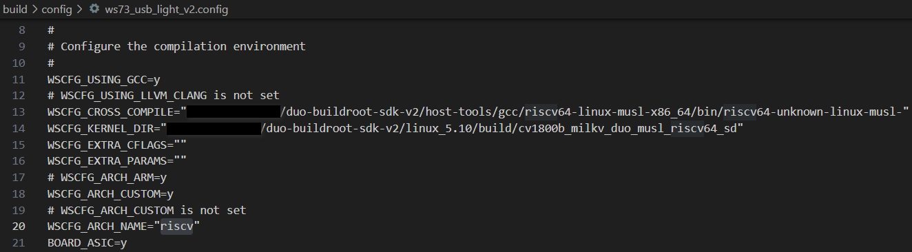

修改Makefile
DEFAULT_KCONFIG_CONFIG := $(CONFIG_DIR)/ws73_usb_light_v2.config
修改build/config/ws73_usb_light_v2.config
WSCFG_CROSS_COMPILE="<dir>/duo-buildroot-sdk-v2/host-tools/gcc/riscv64-linux-musl-x86_64/bin/riscv64-unknown-linux-musl-"
WSCFG_KERNEL_DIR="<dir>/duo-buildroot-sdk-v2/linux_5.10/build/cv1800b_milkv_duo_musl_riscv64_sd"
# WSCFG_ARCH_ARM=y
WSCFG_ARCH_CUSTOM=y
WSCFG_ARCH_NAME="riscv"

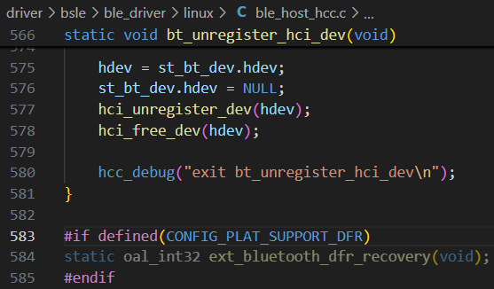

修改driver/bsle/ble_driver/linux/ble_host_hcc.c
#if defined(CONFIG_PLAT_SUPPORT_DFR)
static oal_int32 ext_bluetooth_dfr_recovery(void);
#endif

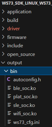

编译输出目录output/bin

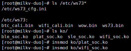

将驱动,固件,配置文件发送到duo开发板
scp firmware/us/*.bin root@192.168.42.1:/etc/ws73
scp output/bin/ws73_cfg.ini root@192.168.42.1:/etc
scp output/bin/*.ko root@192.168.42.1:/root/ko

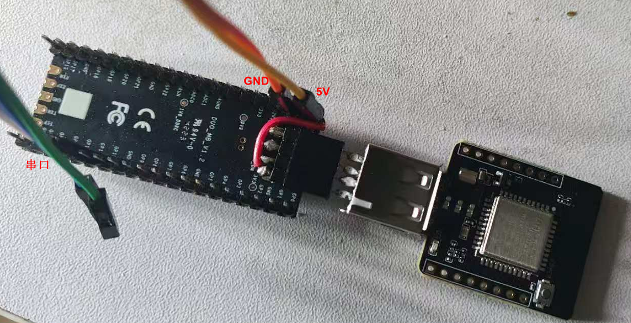

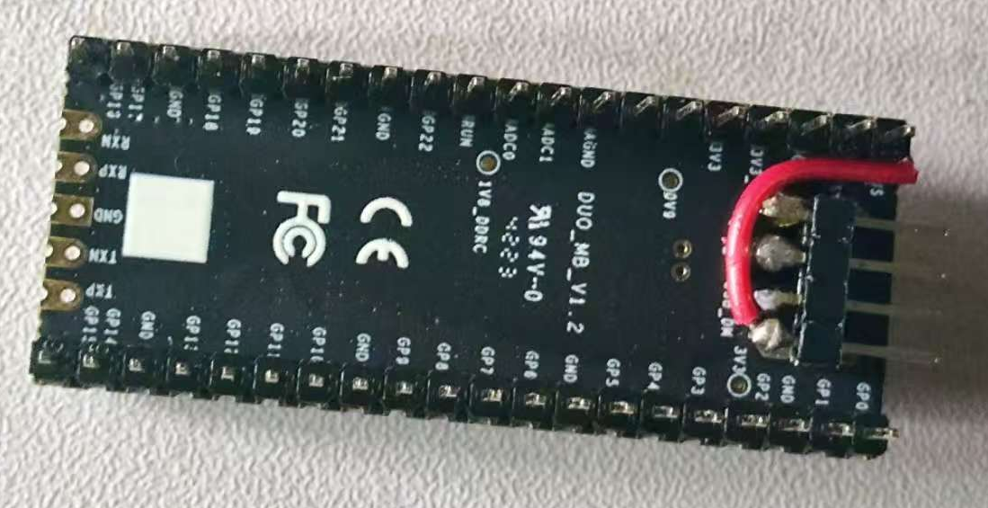

串口连接duo开发板

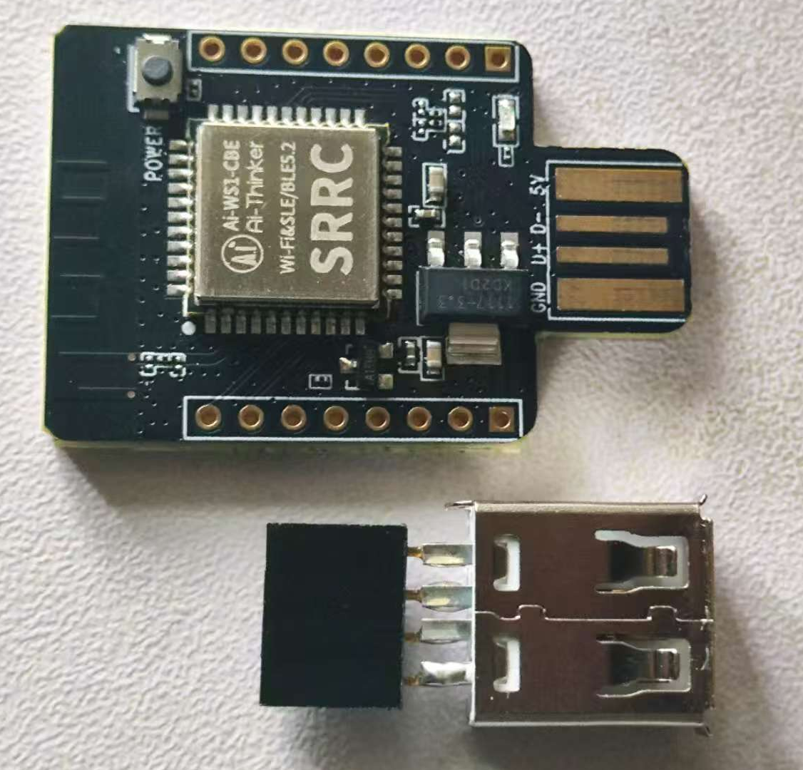

使用USB口连接Ai-WS1-CBE-Kit,所以USB需要配置为host,UsbNcm无法使用,只能通过串口连接duo开发板
启用usb-host
ln -sf /mnt/system/usb-host.sh /mnt/system/usb.sh
reboot

加载驱动
insmod ko/plat_soc.ko
insmod ko/wifi_soc.ko

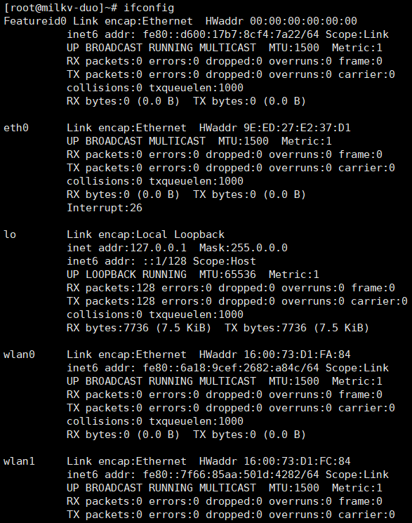

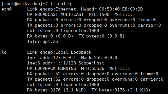

查看网络接口 ifconfig,多出来Featureid0, wlan0, wlan1

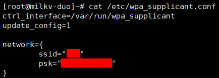

修改/etc/wpa_supplicant.conf,将wifi ssid和密码写入配置文件

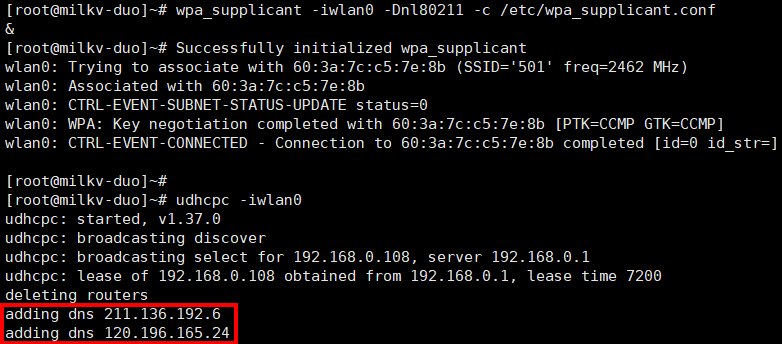

wpa_supplicant -iwlan0 -Dnl80211 -c /etc/wpa_supplicant.conf &
udhcpc -iwlan0
添加nameserver
echo $'nameserver 211.136.192.6\nnameserver 120.196.165.24\nnameserver 8.8.8.8' >> /etc/resolv.conf
cat /etc/resolv.conf

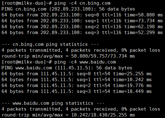

ping测试
ping -c4 cn.bing.com
ping -c4 www.baidu.com
