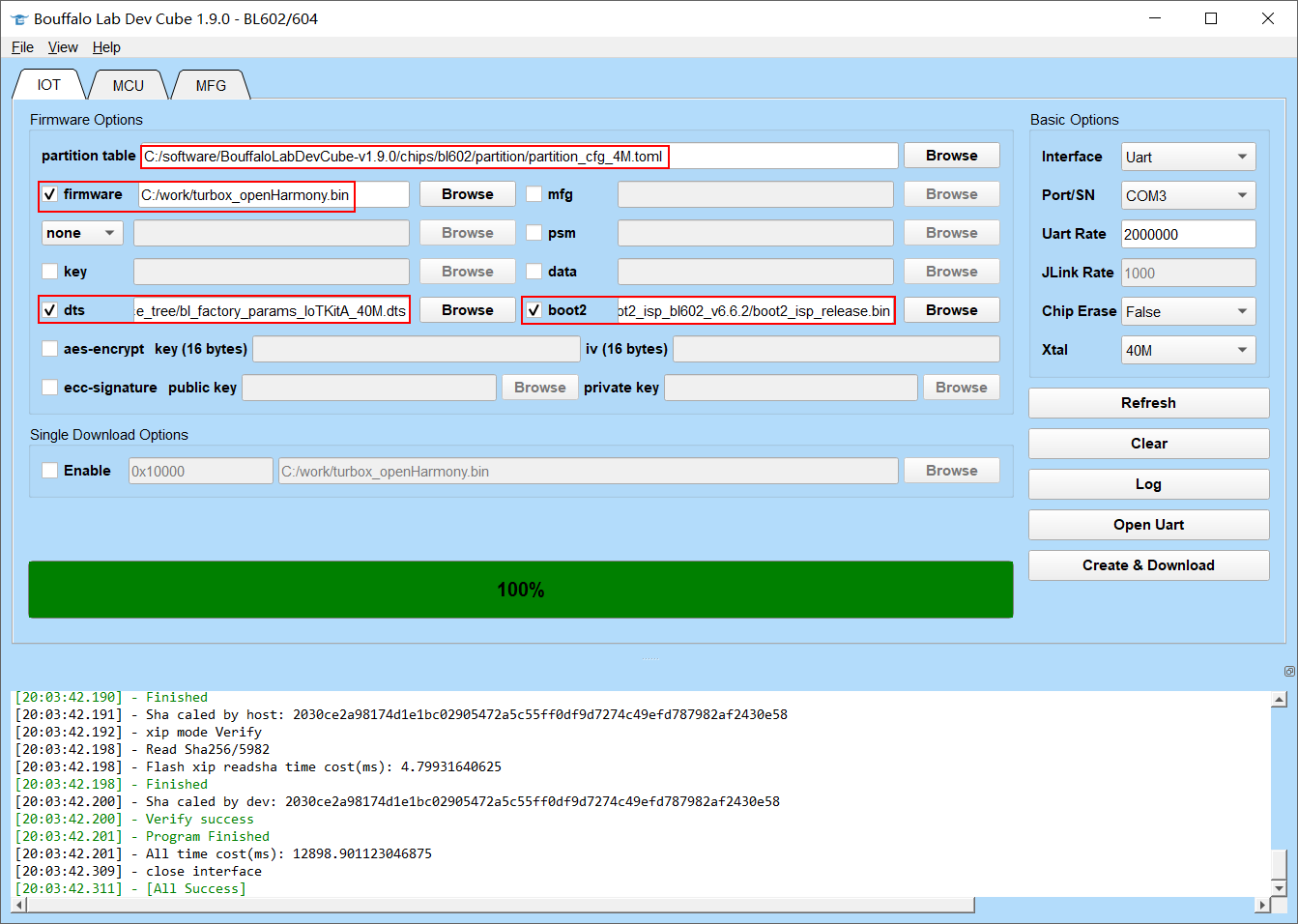

前面搭建OpenHarmony环境时编译生成了turbox_openHarmony.bin,下面将固件烧录到Ai-WB2-32S开发板中
先把固件复制到Windows中,然后打开Bouffalo Lab Dev Cube,选择BL602/604
选择固件同时把dts,boot2选上

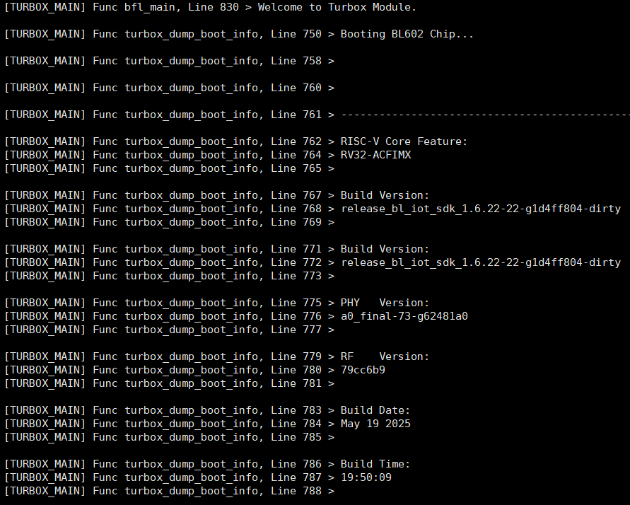

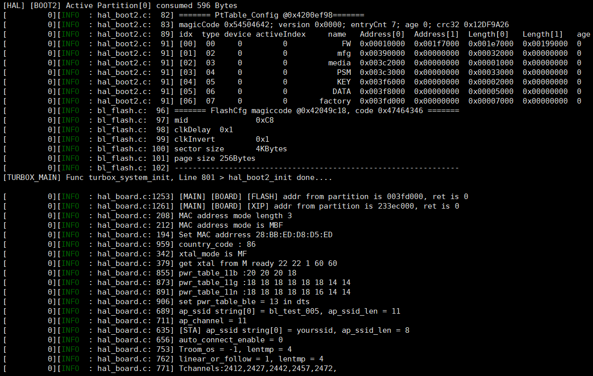

烧录后,重启板子,串口上位机设置波特率921600

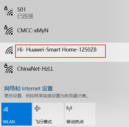

启动后,板子开启了AP: Hi-Huawei-Smart Home-1250Z8

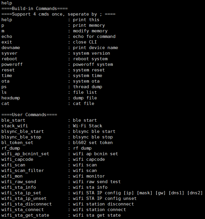

help命令

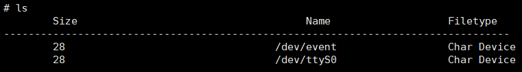

ls命令

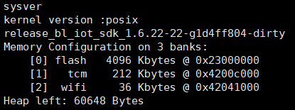

sysver命令

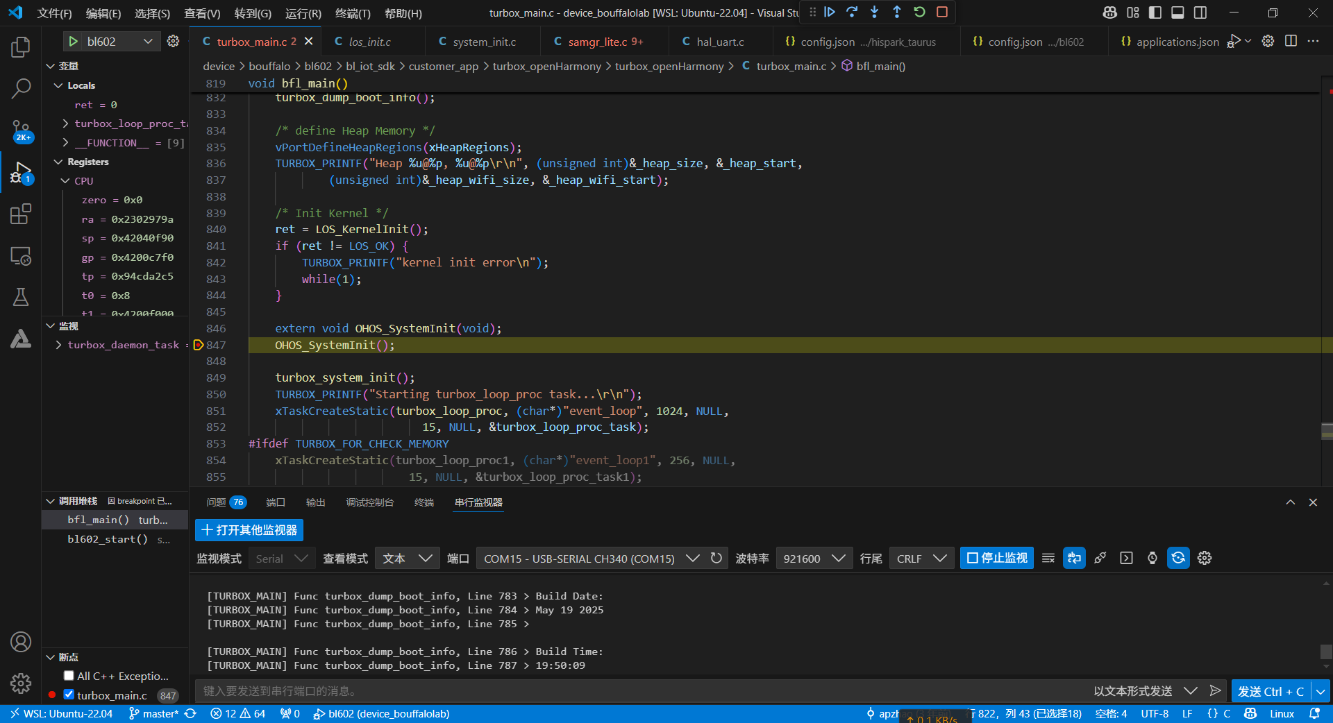

调试
            "name": "bl602",
            "type": "cppdbg",
            "request": "launch",
            "program": "${workspaceFolder}/out/bl602/bl602_wifiModule/turbox_openHarmony.elf",
            "args": [],
            "stopAtEntry": false,
            "cwd": "${workspaceFolder}",
            "environment": [],
            "externalConsole": false,
            "MIMode": "gdb",
            "miDebuggerPath": "${workspaceFolder}/device/bouffalo/bl602/bl_iot_sdk/toolchain/riscv/Linux/bin/riscv64-unknown-elf-gdb",
            "miDebuggerArgs": "-ex \"target remote 172.17.192.1:3333\" -x ${workspaceFolder}/device/bouffalo/bl602/bl_iot_sdk/tools/debug/602_gdb.init",
            "svdPath": "${workspaceFolder}/device/bouffalo/bl602/bl_iot_sdk/tools/debug/602.svd",
            "setupCommands": [
                    "description": "为 gdb 启用整齐打印",
                    "text": "-enable-pretty-printing",
                    "ignoreFailures": true
                    "description": "将反汇编风格设置为 Intel",
                    "text": "-gdb-set disassembly-flavor intel",
                    "text": "mon reset halt",
