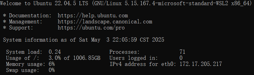

安装WSL2
https://learn.microsoft.com/zh-cn/windows/wsl/install
https://documentation.ubuntu.com/wsl/en/stable/howto/install-ubuntu-wsl2/

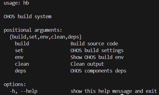

查看hb帮助 hb -h

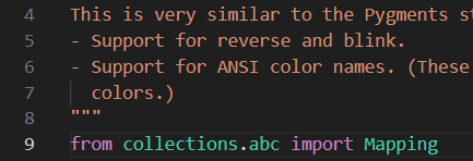

如果提示 ImportError: cannot import name 'Mapping' from 'collections',需要将 miniconda3/lib/python3.12/site-packages/prompt_toolkit/styles/from_dict.py第9行代码 from collections import Mapping替换为 from collections.abc import Mapping

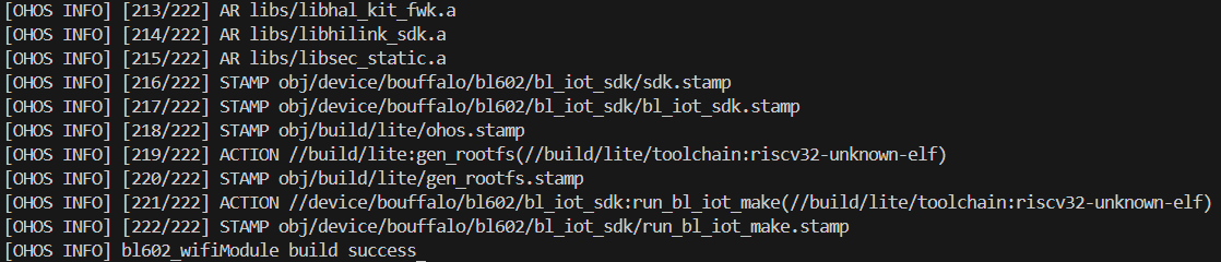

编译
将toolchain路径添加进PATH
export PATH=~/device_bouffalolab/device/bouffalo/bl602/bl_iot_sdk/toolchain/riscv/gcc_riscv32/bin:$PATH

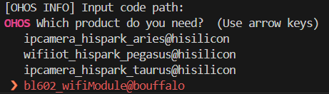

设置编译项目 hb set
提示 Input code path,先回车,然后选择 bl602_wifiModule@bouffalo

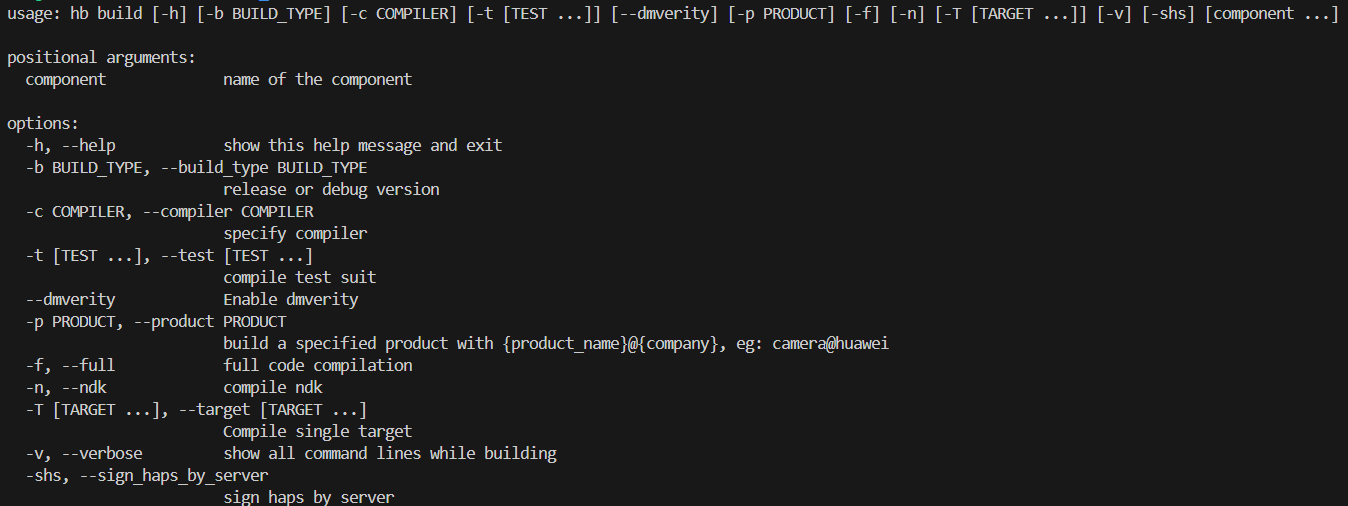

查看编译帮助 hb build -h

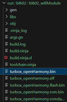

编译 hb build -b release -f -c gcc
image.png输出文件目录 out/bl602/bl602_wifiModule
