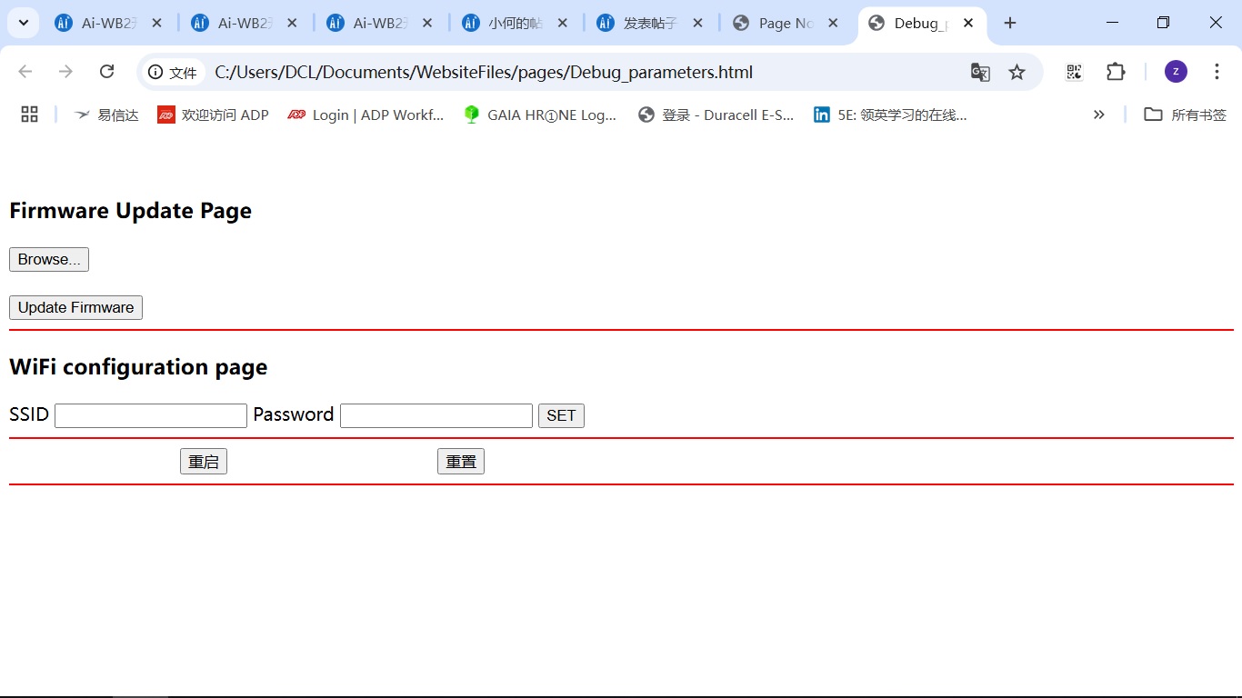

先编写html网页,由于不会美工,都没用CCS。
    <h2 align="center" id="SSE_ID"></h2>
    <h5 align="center">
        <input type="time" class="spin_button"  id="utc_8" style="border:none;font-size:32px;font-weight:bold;display:none" disabled>
    </h5>
    <hr color="red"/>
    <!-- chrome ID=Pairing_ID-->
    <!-- 火狐 type=number-->
    <style type="text/css">
        input[ID=Pairing_ID]::-webkit-outer-spin-button, input[ID=Pairing_ID]::-webkit-inner-spin-button {
            -webkit-appearance: none!important;margin:0;
        input[type=number]{
                -moz-appearance:textfield;
    </style>
    <label for="Pairing">Pincode:</label>
    <label for="Pairing" id="Pincode"></label>
    <br>
    <label for="Pairing">Pairing_On_Network:Node_ID:</label>
    <input type="number" id="Pairing_ID" name="node_id" placeholder="Node_ID" value='' step="1" required>
    <input type="button" id="Pairing" value="确认">
    <br>
    亮度调整:<input type="text" id="num" value="128" style="width:22px" disabled>
    <input type="range" id="luminance" min="10" max="254" step="1" value="128">
    <!-- 标题标签 -->
    <h3>Firmware Update Page</h3>
    <!-- 标题标签 id选择器 -->
    <h4 id="latest_firmware"></h4>
    <!-- input标签 输入类型:文件 id选择器 文件类型 jquery控件不显示 事件会在域的内容改变时发生;事件也可用于单选框与复选框改变后触发的事件。 -->
    <!-- none = 隐藏; inline = 显示 -->
    <input type="file" id="selectedFile" accept=".bin" style="display: none;" >
    <input type="button" value="Browse..." >
    <h4 id="file_info"></h4>
    <input type='submit' id="upload_button" value='Update Firmware'>
    <div class="wifi_ap">
        <hr color="red"/>
        <h3>WiFi configuration page</h3>
        <label for="ssid_text">SSID</label>
        <input type="text" name="ssid_text" id="ssid_text" required>
        <label for="pass_text">Password</label>
        <input type="text" name="pass_text" id="pass_text" minlength="8" required>
        <input type="button" id="set_config" value="SET">
    </div>
    <hr color="red"/>
    <input type="button" id="restart" value="重启" style="margin-left:150px;">
    <input type="button" id="reset" value="重置" style="margin-left:180px;">

        $(document).ready(function() {
            $("#set_config").click(function() {
                if(ssid_text.value != '')
                    if(pass_text.value.length > 7){
                        HtmlToMcu("ssid:" + ssid_text.value + "pass:" + pass_text.value);
                    else{
                        alert('SSID空或Password少于8位\n');
                    console.log("ssid:" + ssid_text.value + "pass:" + pass_text.value);
                    if(set_config_color == 1){
                        //document.getElementById("set_config").style.background="blue";
                        set_config.style.background="blue";
                        set_config_color = 0;
                    else{
                        //document.getElementById("set_config").style.background="red";
                        set_config.style.background="red";
                        set_config_color = 1;
                    location.replace("index");
                else
                    let errorText = ''
                    if(ssid_text.value == '') {
                        errorText = 'Missing SSID\n';
                    alert(errorText);
            $("#Page_feed").click(function() {
                HtmlToMcu("page_feed:" + 65537);
                console.log("page_feed:" + 65537);
            $("#time_id").click(function() {
                HtmlToMcu("page_feed:" + 196611);
                console.log("page_feed:" + 196611);
                location.replace("time");
            $("#restart").click(function() {
                let r = confirm("确认重起")
                if(r == true){
                    HtmlToMcu("restart:" + 170);
                    console.log("restart:" + 170);
                else{
            $("#reset").click(function() {
                let r = confirm("确认重置")
                if(r == true){
                    HtmlToMcu("reset:" + 170);
                    console.log("reset:" + 170);
                else{
            $("#test_function").click(function() {
                test_function.style.background="green";
                HtmlToMcu("test_set:" + 170);
                console.log("test_set:" + 170);
        });//(document).ready(function()
    </script>

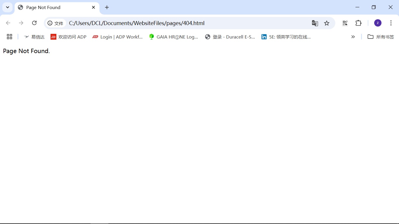

<!DOCTYPE html><html lang="en"><head><title>Page Not Found</title></head><body>Page Not Found.</body></html>

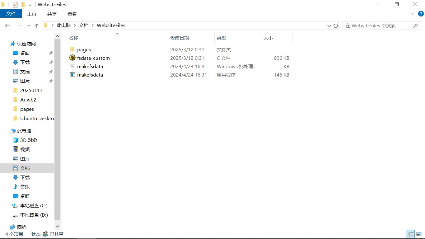

使用LWIP官方的makefsdata工具生成数据文件fsdata_custom.c,在windows下运bat文件就好
工具及网页Html打包上传
上传的附件: WebsiteFiles.rar (169.71 KB, 下载次数: 0)
