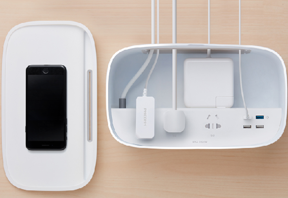

## 插座盒子tc1介绍
硬件:
4个USB充电,6个插孔
功能:
按键控制所有插口通断
控制每个接口独立开关
MQTT服务器连接控制
通过mqtt连入homeassistant
实时显示功率,运行时间

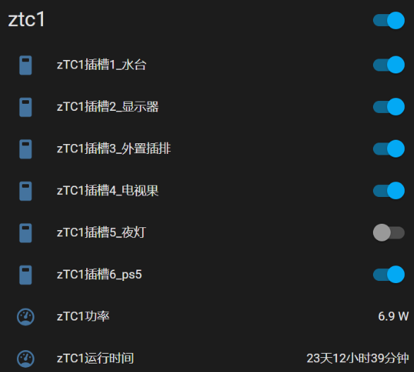

  81.       payload_available: 1
  82.       payload_not_available: 0
  83.   - sensor:
  84.       name: 'ztc1_power_macmac'
  85.       unique_id: ztc1_power_macmac
  86.       state_topic: 'device/ztc1/macmac/sensor'
  87.       unit_of_measurement: 'W'
  88.       icon: 'mdi:gauge'
  89.       value_template: '{{ value_json.power }}'
  90.       availability_topic: "device/ztc1/macmac/availability"
  91.       payload_available: 1
  92.       payload_not_available: 0
  93.   - sensor:
  94.       name: 'ztc1_time_macmac'
  95.       unique_id: ztc1_time_macmac
  96.       state_topic: 'device/ztc1/macmac/sensor'
  97.       #unit_of_measurement: '秒'
  98.       icon: 'mdi:gauge'
  99.       availability_topic: "device/ztc1/macmac/availability"
  100.       payload_available: 1
  101.       payload_not_available: 0
  102.       #value_template: '{{ value_json.total_time }}'
  103.       value_template: >-
  104.         {% set time = value_json.total_time %}
  105.         {% set minutes = ((time % 3600) / 60) | int %}
  106.         {% set hours = ((time % 86400) / 3600) | int %}
  107.         {% set days = (time / 86400) | int %}
  108.         {%- if time < 60 -%}
  109.           <1分钟
  110.         {%- else -%}
  111.           {%- if days > 0 -%}
  112.               {{ days }}天
  113.           {%- endif -%}
  114.           {%- if hours > 0 -%}
  115.               {{ hours }}小时
  116.           {%- endif -%}
  117.           {%- if minutes > 0 -%}
  118.               {{ minutes }}分钟
  119.           {%- endif -%}
  120.         {%- endif -%}
  121. homeassistant:
  122.   customize:
  123.     switch.ztc1_1_macmac:
  124.       friendly_name: zTC1插槽1_水台
  125.     switch.ztc1_2_macmac:
  126.       friendly_name: zTC1插槽2_显示器
  127.     switch.ztc1_3_macmac:
  128.       friendly_name: zTC1插槽3_外置插排
  129.     switch.ztc1_4_macmac:
  130.       friendly_name: zTC1插槽4_电视果
  131.     switch.ztc1_5_macmac:
  132.       friendly_name: zTC1插槽5_夜灯
  133.     switch.ztc1_6_macmac:
  134.       friendly_name: zTC1插槽6_ps5
  135.     sensor.ztc1_power_macmac:
  136.       friendly_name: zTC1功率
  137.     sensor.ztc1_time_macmac:
  138.       friendly_name: zTC1运行时间

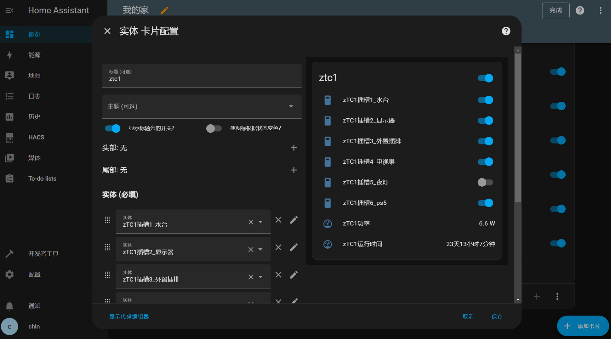

  1. vim config/configuration.yaml
  2. homeassistant:
  3.   packages: !include_dir_named packages
    4.重启ha
# 卡片设置
