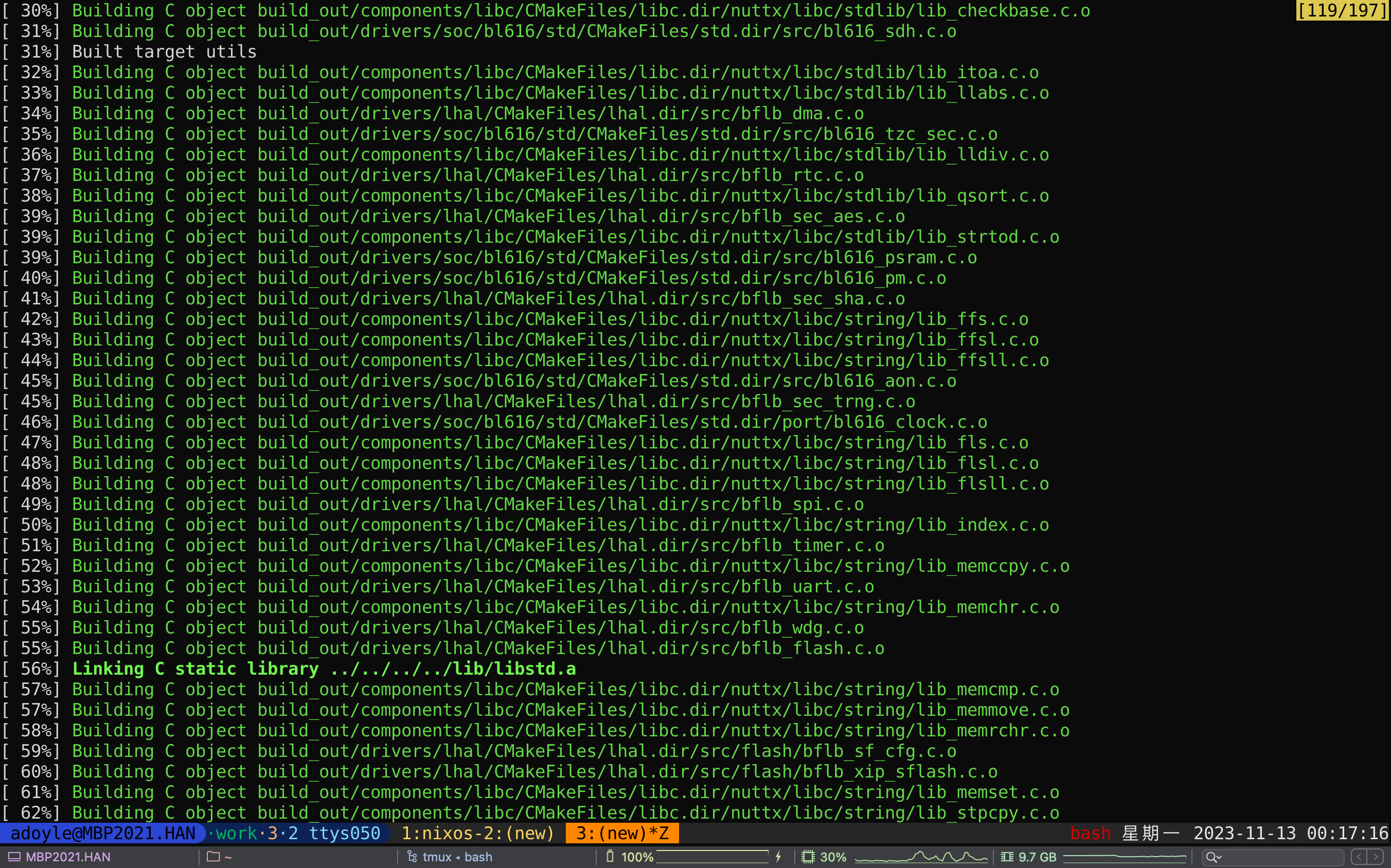

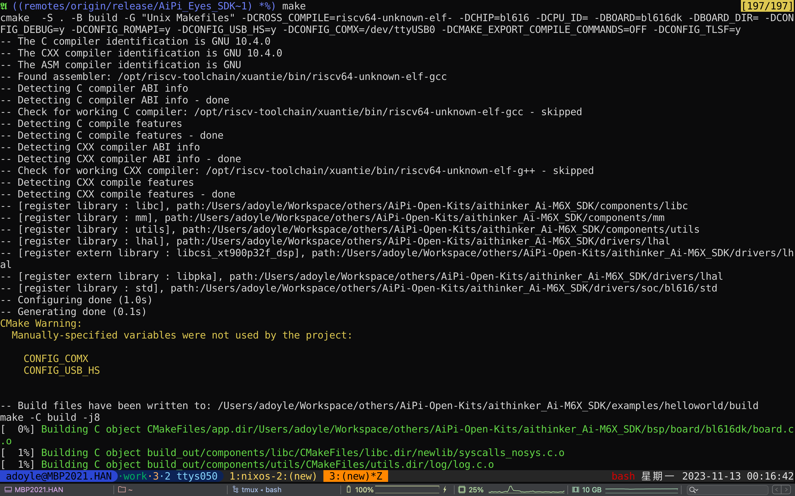

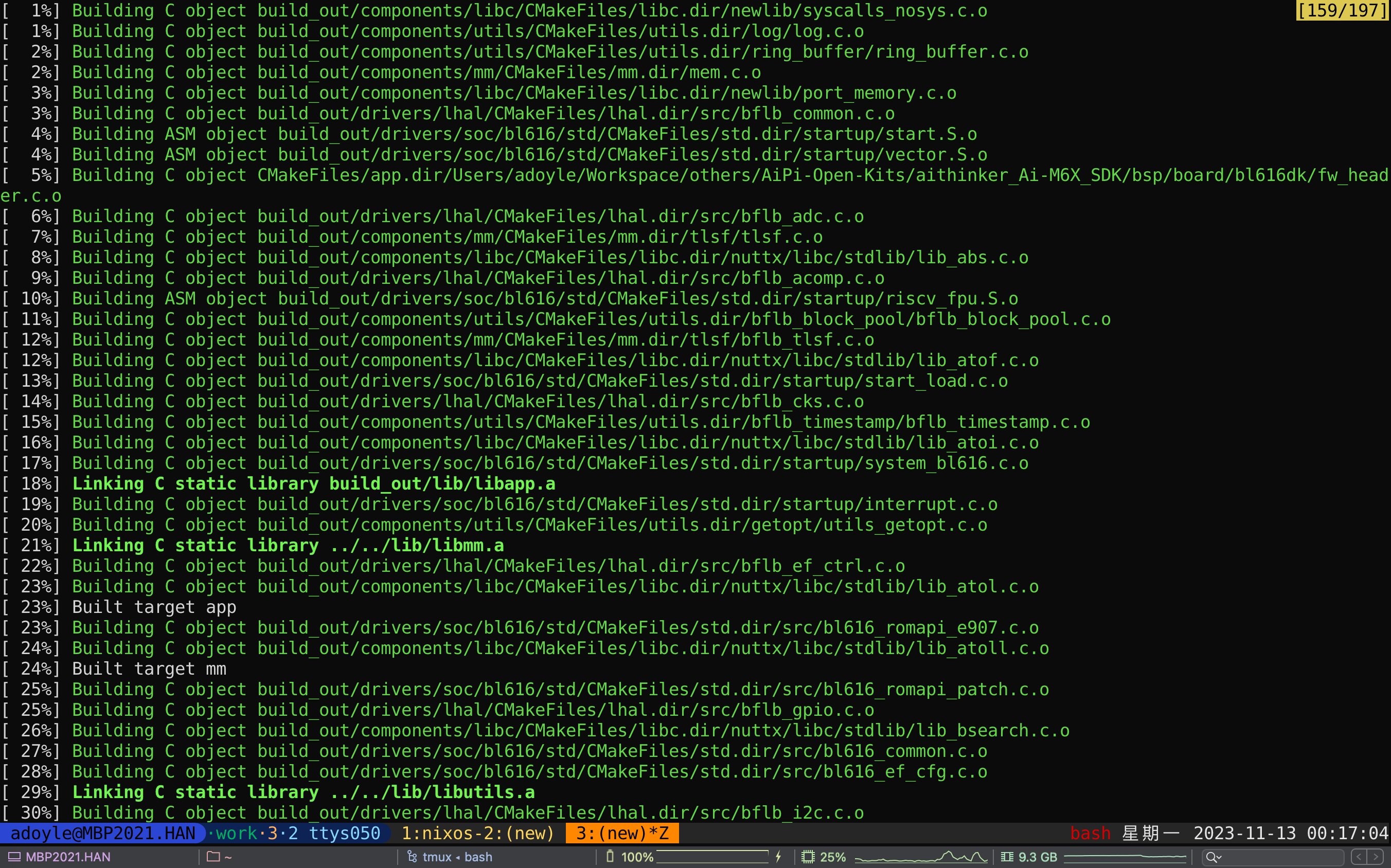

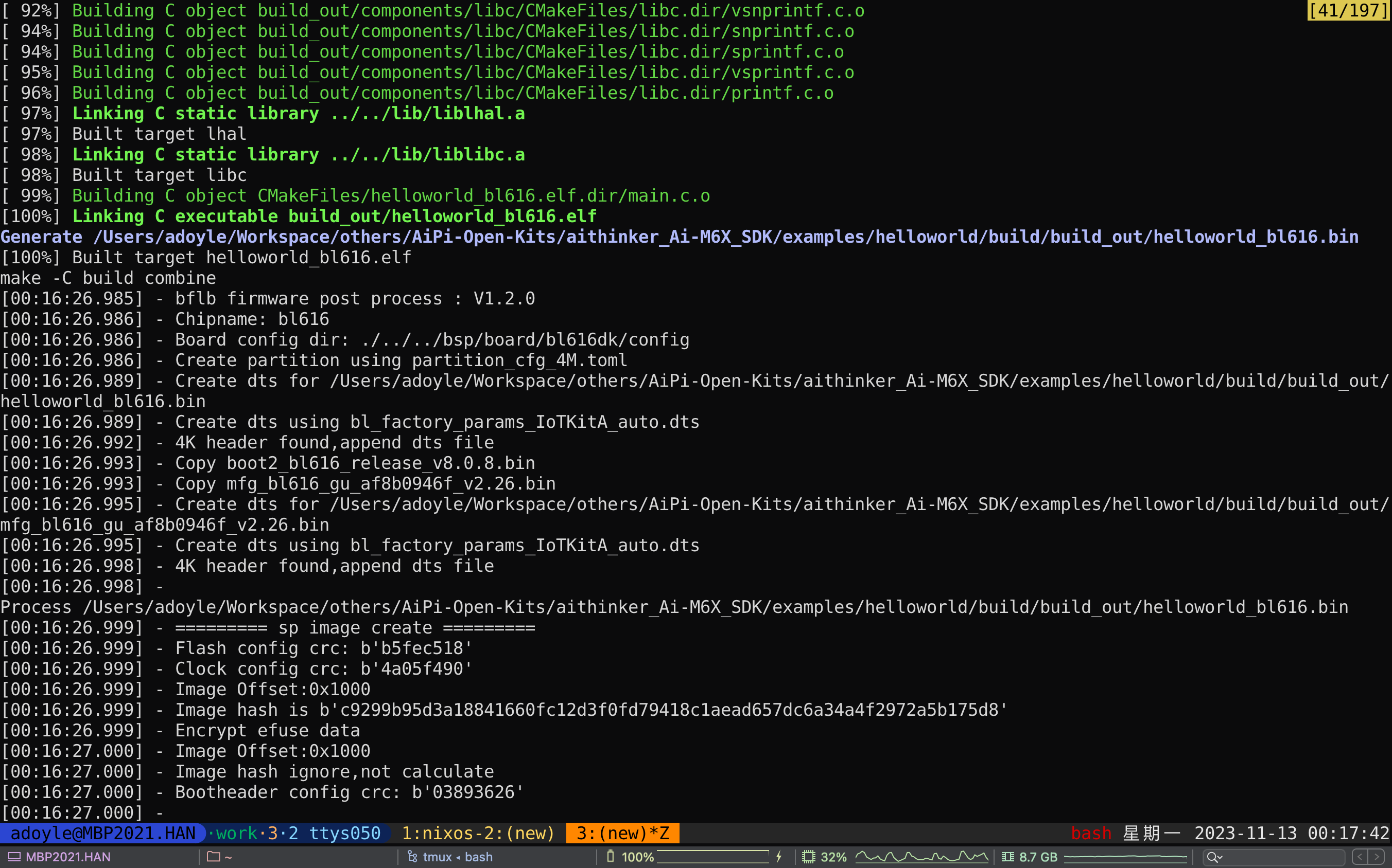

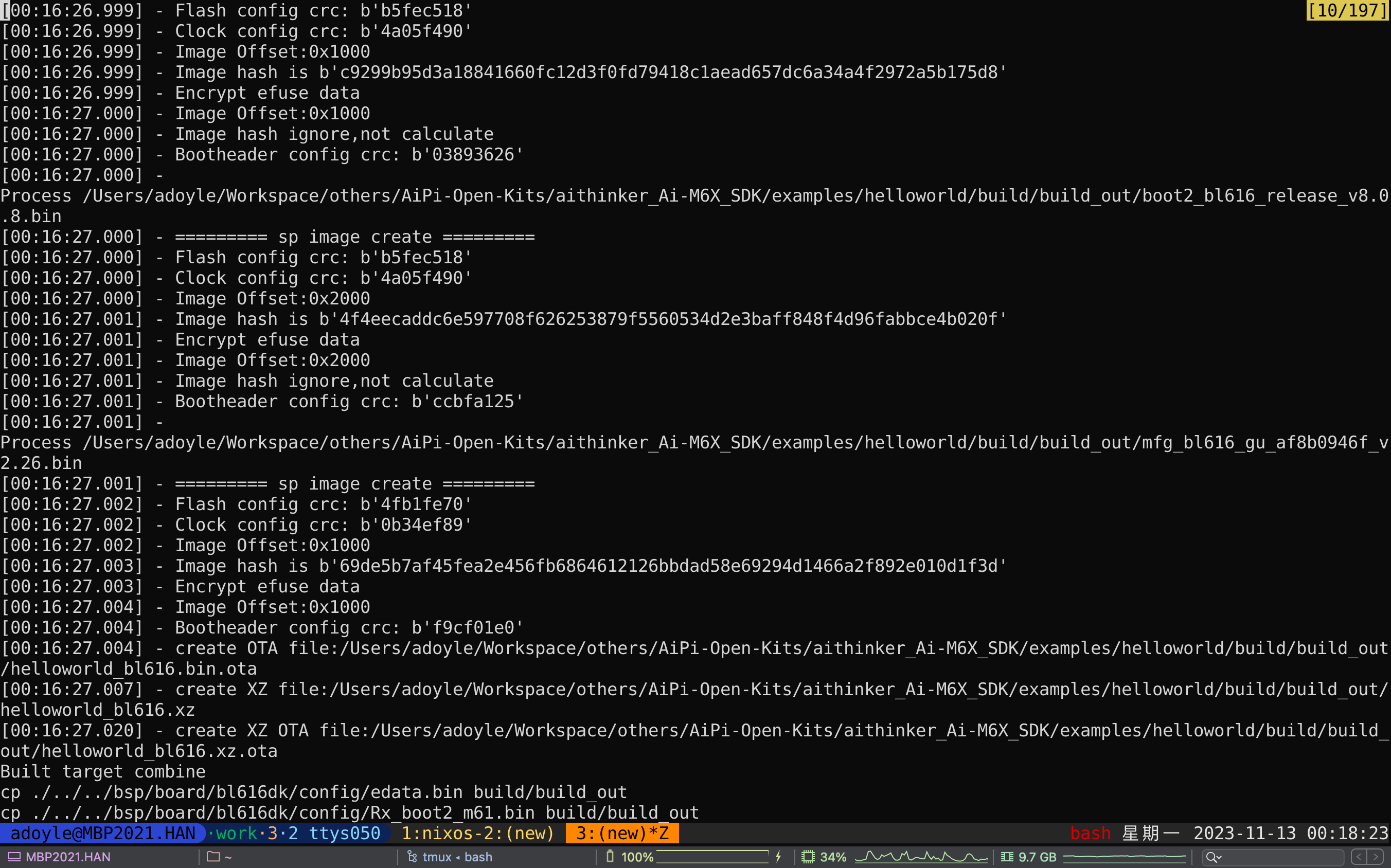

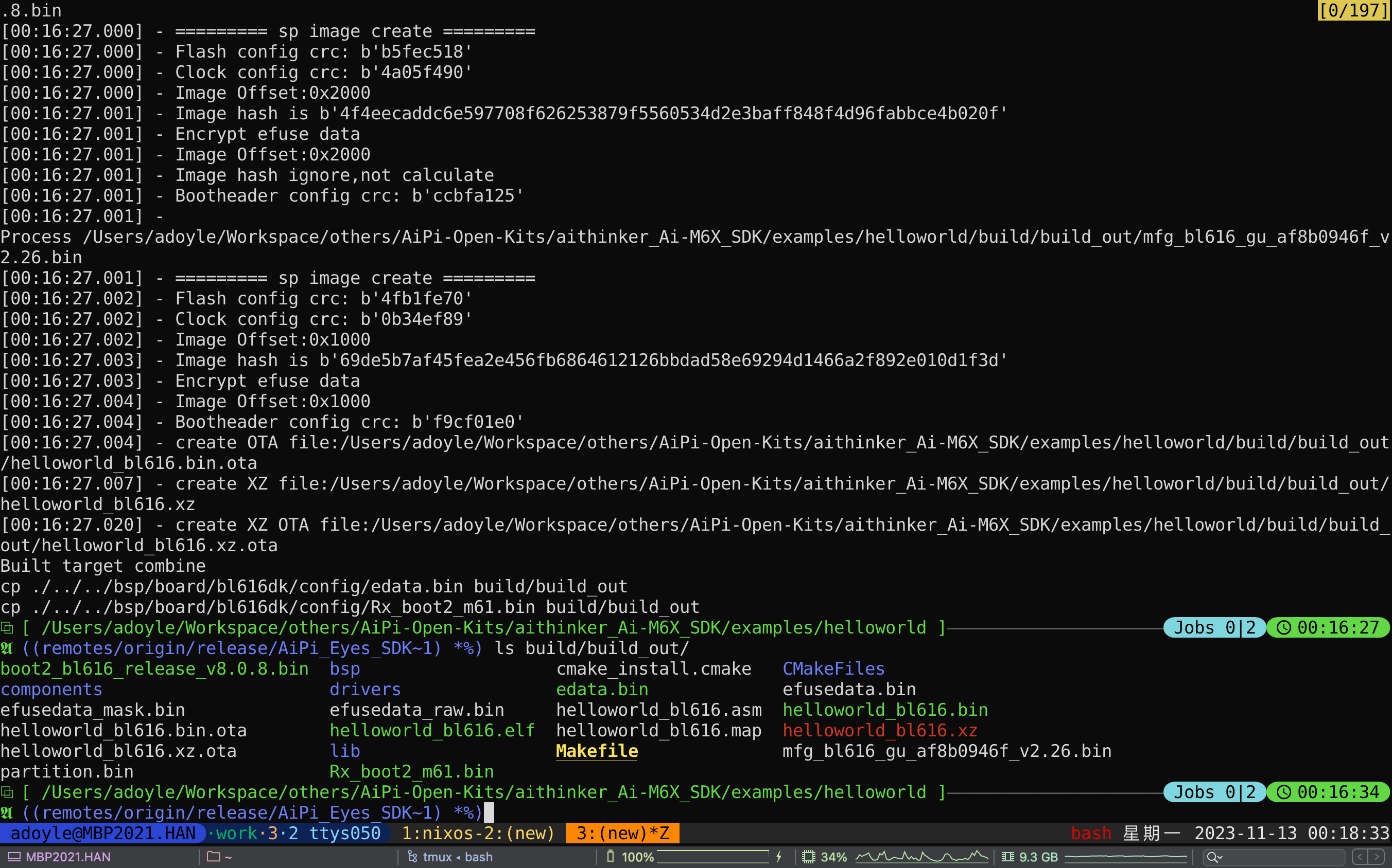

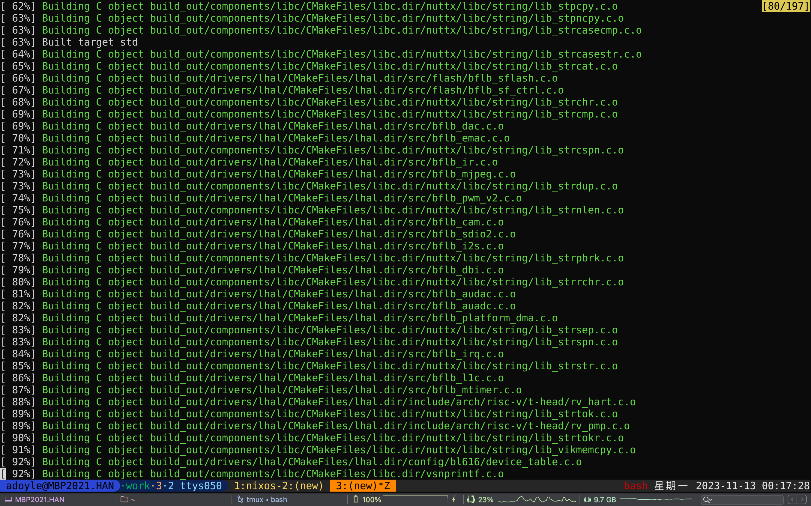

## 看下编译成果
CleanShot 2023-11-13 at 00.16.42@2x.png CleanShot 2023-11-13 at 00.17.04@2x.png CleanShot 2023-11-13 at 00.17.17@2x.png CleanShot 2023-11-13 at 00.17.28@2x.png CleanShot 2023-11-13 at 00.17.43@2x.png CleanShot 2023-11-13 at 00.18.24@2x.png CleanShot 2023-11-13 at 00.18.34@2x.png
