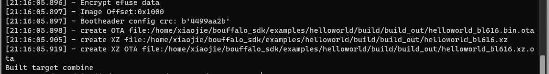

按照教程
  1. $ cd ~
  2. $ git clone https://github.com/bouffalolab/bouffalo_sdk.git #
github拉不下来
提示
remote: Enumerating objects: 31151, done.
remote: Counting objects: 100% (3299/3299), done.
remote: Compressing objects: 100% (2096/2096), done.
error: RPC failed; curl 56 GnuTLS recv error (-9): Error decoding the received TLS packet.
error: 5406 bytes of body are still expected
fetch-pack: unexpected disconnect while reading sideband packet
fatal: early EOF
fatal: fetch-pack: invalid index-pack output
使用了魔法都拉不下来
newbing简易修改git 缓存,无效
  1. git config --global http.postBuffer 1048576000
  2. git config --global https.postBuffer 1048576000
stackoverflow建议git卸载重新装 无效
https://stackoverflow.com/questi ... redirect=1&lq=1
最终改成拉gitee的库
  1. git clone https://gitee.com/bouffalolab/bouffalo_sdk.git
下载工具链
  1. $ git clone https://gitee.com/bouffalolab/toolchain_gcc_t-head_linux.git
复制到bin目录下
  1. sudo cp -rf toolchain_gcc_t-head_linux/ /usr/bin
如果已切换到root,就不用sudo
  1. su root
输入密码
切换到root
  1. echo "export PATH="$PATH:/usr/bin/toolchain_gcc_t-head_linux/bin""  >> ~/.bashrc
>> 表示在 ~/.bashrc 文末添加这一行内容
  1. source ~/.bashrc
用于在当前 shell 会话中重新加载 ~/.bashrc 文件
安装make
  1. $ cd ~
  2. $ sudo apt install make -y
安装ninja
  1. $ cd ~
  2. $ sudo apt install ninja-build -y
查看有没有安装成功
  1. make -v
查看是否有make的版本信息
查看编译链是否安装成功,是否有版本信息
  1. $ riscv64-unknown-elf-gcc -v
如果提示没有这跟命令,确认一下环境变量有没有装好
进入helloword目录make
  1. $ cd examples/helloworld
  2. $ make CHIP=chip_name BOARD=board_name
提示成功
