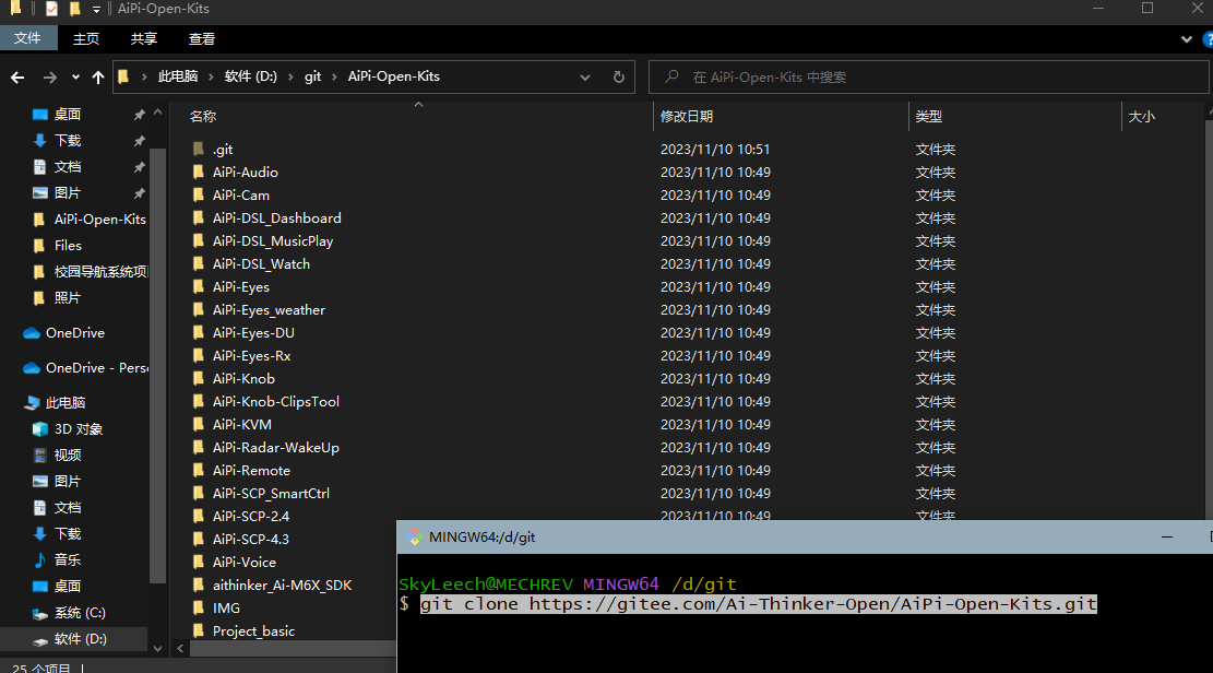

1.克隆源码
  1. git clone https://gitee.com/Ai-Thinker-Open/AiPi-Open-Kits.git

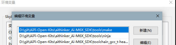

3.编译工具路径设置
所有都拉取完成之后,需要把三个路径加入到电脑的环境变量当中
  1. aithinker_Ai-M6X_SDK\toolchain_gcc_t-head_windows\bin
  2. aithinker_Ai-M6X_SDK\tools\make
  3. aithinker_Ai-M6X_SDK\tools\ninja

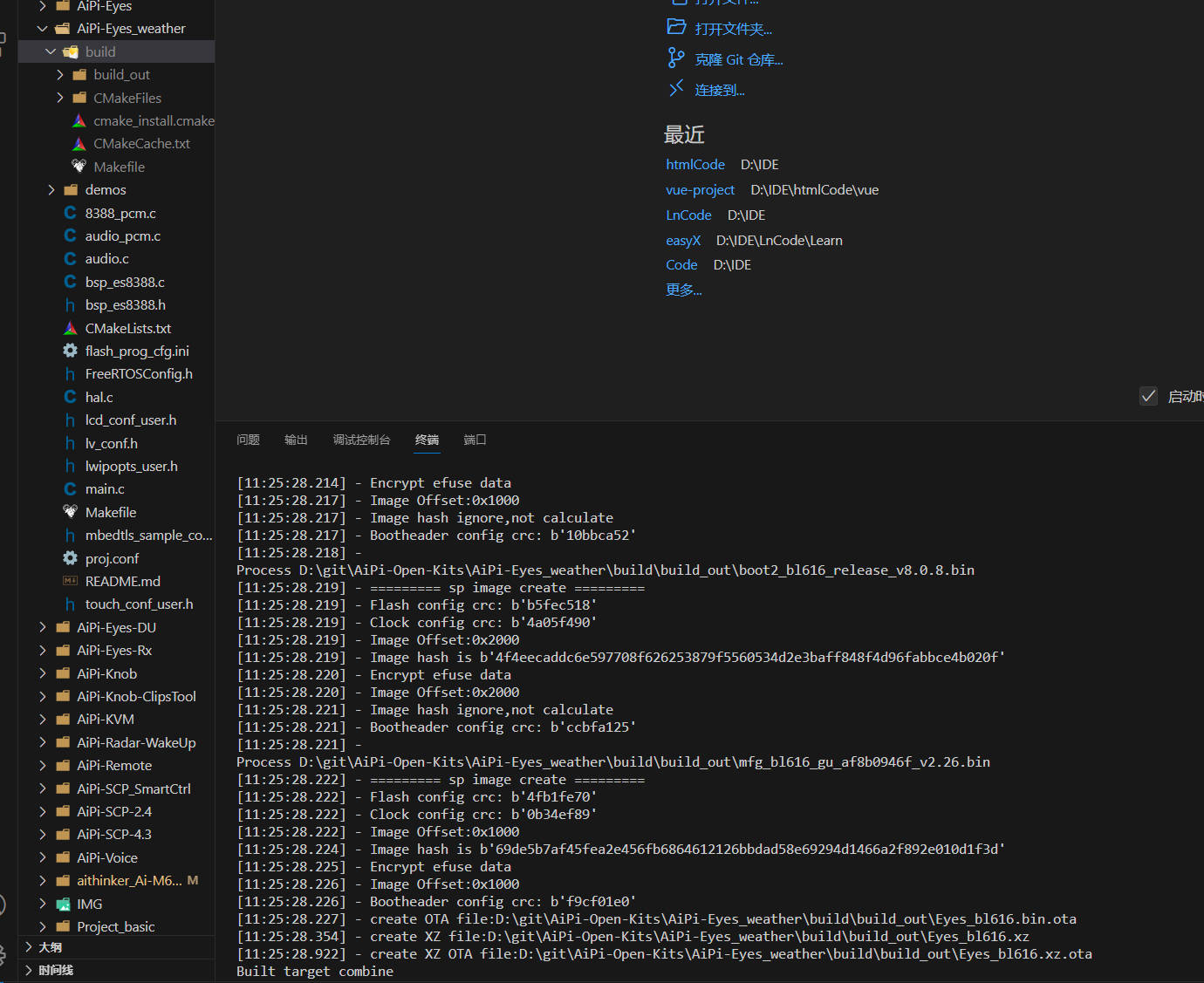

5.编译天气站程序
