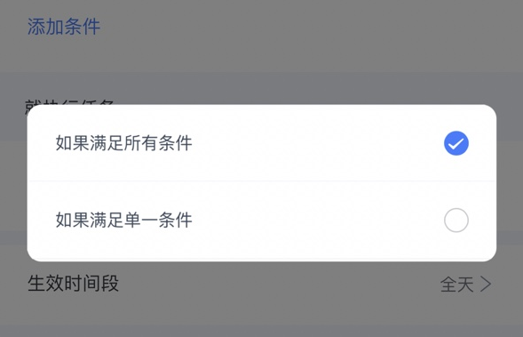

    //如果为任意条件满足,同时当前设置条件中已有条件满足,则直接执行
    if iotconst.ConditionModel(intellObj.ConditionMode) == iotconst.CONDITION_MODEL_2 &&
       resultFlag.EveryOneTrue() {
       break
//根据规则判断条件满足规则
switch iotconst.ConditionModel(intellObj.ConditionMode) {
case iotconst.CONDITION_MODEL_1:
   isExecutor = resultFlag.AllTrue()  //全部条件满足
case iotconst.CONDITION_MODEL_2:
   isExecutor = resultFlag.EveryOneTrue() //任意条件满足

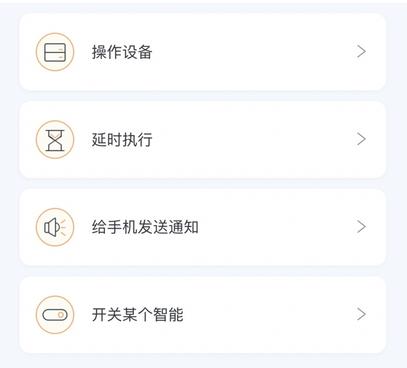

最后如果isExecutor=true则开始按照步骤执行任务
在ExecuteTask方法中支持操作设备、延时执行、给手机发送通知、开关某个智能等任务的处理,每个任务都会单独记录日志并反馈给APP用户;
//以下内容为ExecuteTask函数的节选代码
for _, task := range intellObj.SceneIntelligenceTask {
    switch iotconst.TaskType(task.TaskType) {
    case iotconst.TASK_TYPE_DEVICE:
       iotlogger.LogHelper.Info("控制")
       setResult(execute.DeviceExecute(userId, resultId, result.RunTime.Unix(), devIds, task))
    case iotconst.TASK_TYPE_INTELL:
       iotlogger.LogHelper.Info("场景开关")
       setResult(execute.SceneIntelligenceExecute(resultId, result.RunTime.Unix(), task))
    case iotconst.TASK_TYPE_DELAYED:
       iotlogger.LogHelper.Info("延时")
       result.RunStatus = 3 //延时执行
       execute.SetResult(result)
       setResult(execute.DelayedExecute(resultId, result.RunTime.Unix(), task))
    case iotconst.TASK_TYPE_SENDMSG:
       iotlogger.LogHelper.Info("通知")
       setResult(execute.NoticeExecute(execute.NoticeParams{
          HomeId:           intellObj.HomeId,
          UserId:           []int64{},
          IntelligenceName: intellObj.Title,
          AppKey:           intellObj.AppKey,
          TenantId:         intellObj.TenantId,
       }, resultId, result.RunTime.Unix(), task))
