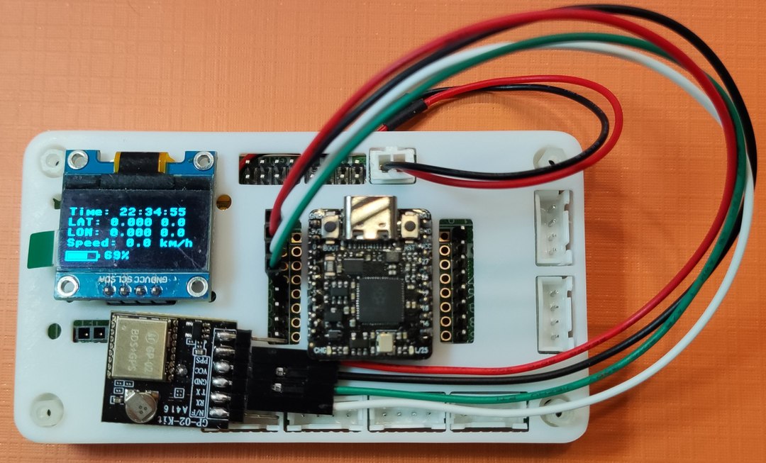

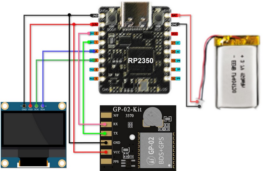

硬件连接
示意图
GP-02
GP-02 RP2350
RX GPIO0
TX GPIO1
VCC 3V3
GND GND
OLED
  • GP4 ---- SDA (OLED_SSD1306)
  • GP5 ---- SCL (OLED_SSD1306)

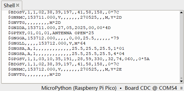

包括串口读取 GP-02 模组原始数据、NVEA 数据解析,为之后的代码合并和调用作铺垫。

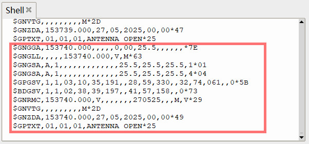

原始数据
串口连接 GP-02 模组,终端打印原始串口数据
代码
Version: v1.0
Date: 2025.05
Author: ljl
Other: Acquiring origin GPS data and print them in Shell
from machine import Pin, UART
import time
# initialize UART
gps_uart = UART(0, baudrate=9600, tx=Pin(0), rx=Pin(1))
def read_gps_data():
    """ Read GPS data and print """
    if gps_uart.any():
        line = gps_uart.readline().decode('utf-8').strip()
        print(f"{line}")
while True:
    read_gps_data()
    time.sleep(0.05)
连接芯片,配置解释器,运行代码。
效果
终端打印原始 NVEA 数据
分别给出几种不同卫星定位系统的数据

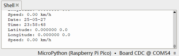

效果
终端打印日期、时间、经纬度、速度信息

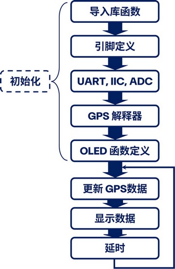

流程图
工程代码
在前面获取 GP-02 模组数据并实现转换的基础上,进一步结合 OLED 和电池模块,实现桌面 GPS 授时时钟的设计。
Version: v1.0
Date: 2025.05
Author: ljl
Other: Acquiring GPS data and showing on OLED screen
include data, time, latitude, longtitude and speed.

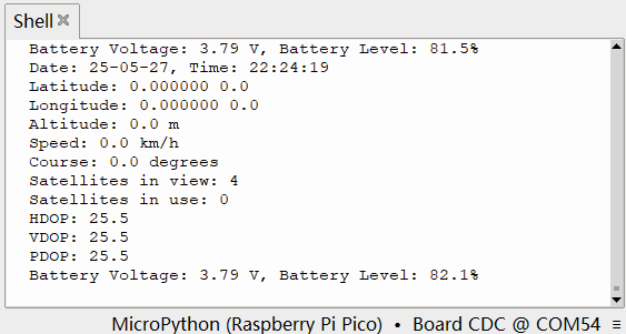

        print(f"Altitude: {my_gps.altitude} m")
        print(f"Speed: {my_gps.speed[2]} km/h")
        print(f"Course: {my_gps.course} degrees")
        print(f"Satellites in view: {my_gps.satellites_in_view}")
        print(f"Satellites in use: {my_gps.satellites_in_use}")
        print(f"HDOP: {my_gps.hdop}")
        print(f"VDOP: {my_gps.vdop}")
        print(f"PDOP: {my_gps.pdop}")
    else:
        print("Waiting for GPS data...")
# parameters of voltage divide resistor
R1, R2 = 1000000, 1000000 # 1M
Vref_BAT = 3.9 # battery voltage in full charged state
def get_battery_level():
    ''' measure battery voltage by ADC '''
    adc_value = adc.read_u16()
    voltage = (adc_value / 65535) * 3.3
    DIV_RATIO = (R1 + R2) / R1
    actual_voltage = voltage * DIV_RATIO  # voltage division compensation
    percent = min(max((actual_voltage - 3.3) / (Vref_BAT - 3.3) * 100, 0), 100)
    return percent, actual_voltage
def BAT_display(percent,x,y,width,height):
    ''' battery percent, icon position and size (x,y,width,height) '''
    oled.fill_rect(x,y,width+2,height+16,0) # part clear
    oled.text('{:.0f}%'.format(percent), width+6+x, y)
    # draw battery icon
    oled.rect(0+x, 0+y, width, height, 1) # frame (x,y,width,height)
    oled.rect(width-1+x, int(height/3)+y, 3, int(height/3), 1)  # anode
    oled.fill_rect(2+x, 2+y, int((width-4) * percent / 100), height-4, 1) # electric percent column
    oled.rotate(0)
    oled.show()
while True:
    update_gps()
    display_data()
    print_gps_data()
    percent, voltage = get_battery_level()
    BAT_display(percent,0,52,30,9)
    print('Battery Voltage: {:.2f} V, Battery Level: {:.1f}%'.format(voltage,percent))
    time.sleep(1)

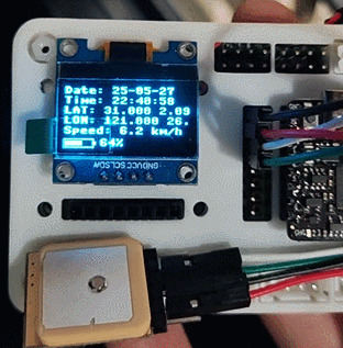

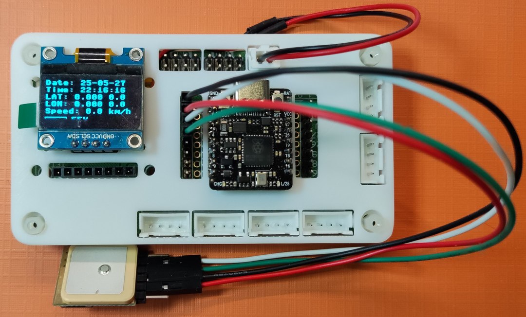

运行代码,确认执行无误后,将代码文件上传至芯片根目录。

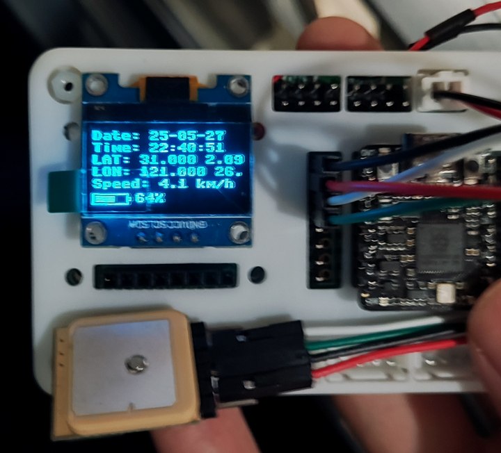

效果演示
连接锂电池供电,显示 GPS 数据,包括日期、时间、经纬度、速度、电池电量信息。
动态效果(每秒刷新一次)
同时终端打印 GPS 数据与电池电量信息

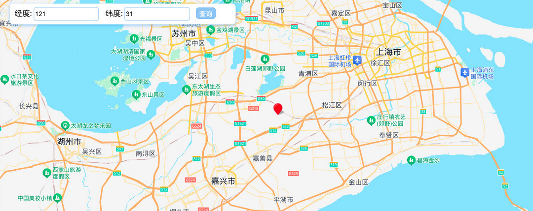

室外测试
室外环境或窗边,等待 30 秒左右,可获取到位置信息
读取经纬坐标信息,输入网络地图,可得到相应的地理位置
将上述采集得到的经纬坐标 (121,31) 输入网址 经纬度定位 ,点击 查询 按钮,可获得对应的地理位置
定位结果与实际位置 (121.45,31.03) 较为接近

GP-02 我也有一个还不知道做什么,在屋子里面也能拿到日期时间么,是不得里窗户近点。
2025-5-28 08:44:23
学习了
2025-5-28 08:55:19
学习了
2025-5-28 09:04:19
WT_0213 发表于 2025-5-28 08:36
GP-02 我也有一个还不知道做什么,在屋子里面也能拿到日期时间么,是不得里窗户近点。 ...
室内可以获取时钟信息,但是收不到经纬度坐标
