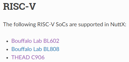

bl602支持nuttx

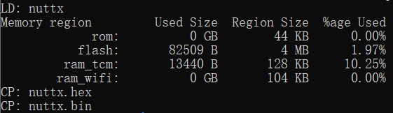

./tools/configure.sh -l bl602evb:nsh

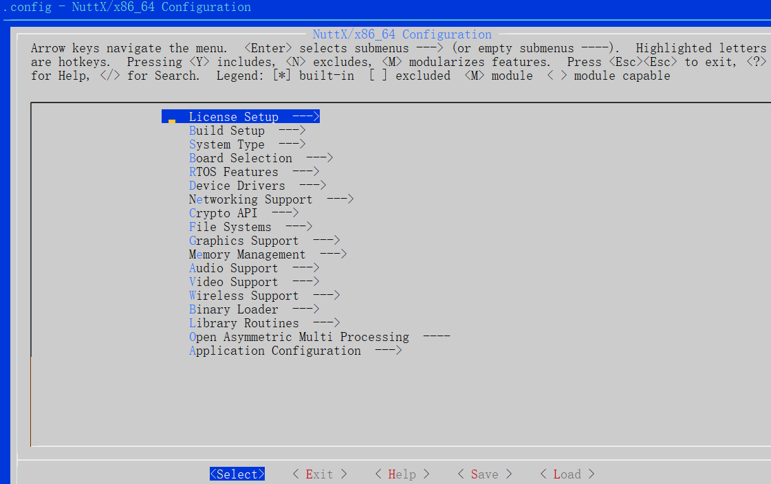

(可选)设置编译选项 make menuconfig
编译 make -j

https://nuttx.apache.org/docs/latest/platforms/risc-v/bl602/index.html
