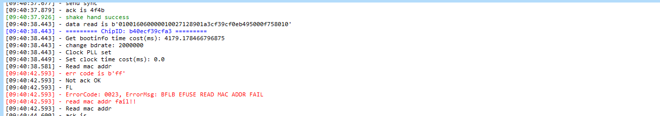

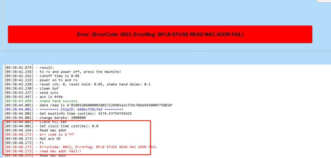

AiPi-DSL无法烧录固件,提示ErrorCode: 0023, ErrorMsg: BFLB EFUSE READ MAC ADDR FAIL异常
[09:40:34.263] - ========= get_boot_info =========
[09:40:34.263] - ========= image get bootinfo =========
[09:40:36.337] - ack is
[09:40:36.337] - Not ack OK
[09:40:36.337] - result:
[09:40:36.622] - tx rx and power off, press the machine!
[09:40:36.622] - cutoff time is 0.05
[09:40:36.675] - power on tx and rx
[09:40:37.677] - reset cnt: 0, reset hold: 0.05, shake hand delay: 0.1
[09:40:37.677] - clean buf
[09:40:37.677] - send sync
[09:40:37.879] - ack is 4f4b
[09:40:37.926] - shake hand success
[09:40:38.443] - data read is b'010016060000010027128901a3cf39cf0eb495000f758010'
[09:40:38.443] - ========= ChipID: b40ecf39cfa3 =========
[09:40:38.443] - Get bootinfo time cost(ms): 4179.178466796875
[09:40:38.443] - change bdrate: 2000000
[09:40:38.443] - Clock PLL set
[09:40:38.449] - Set clock time cost(ms): 0.0
[09:40:38.581] - Read mac addr
[09:40:42.593] - err code is b'ff'
[09:40:42.593] - Not ack OK
[09:40:42.593] - FL
[09:40:42.593] - ErrorCode: 0023, ErrorMsg: BFLB EFUSE READ MAC ADDR FAIL
[09:40:42.593] - read mac addr fail!!
[09:40:42.593] - Read mac addr
[09:40:44.600] - ack is
[09:40:44.600] - Not ack OK
[09:40:44.600] - ErrorCode: 0023, ErrorMsg: BFLB EFUSE READ MAC ADDR FAIL
[09:40:44.600] - read mac addr fail!!
[09:40:44.600] - Read mac addr
[09:40:46.606] - ack is
[09:40:46.606] - Not ack OK
[09:40:46.606] - ErrorCode: 0023, ErrorMsg: BFLB EFUSE READ MAC ADDR FAIL
[09:40:46.606] - read mac addr fail!!
[09:40:46.606] - Read mac addr
[09:40:48.611] - ack is
[09:40:48.611] - Not ack OK
[09:40:48.611] - ErrorCode: 0023, ErrorMsg: BFLB EFUSE READ MAC ADDR FAIL
[09:40:48.611] - read mac addr fail!!
[09:40:48.611] - Read mac addr
[09:40:50.616] - ack is
[09:40:50.616] - Not ack OK
[09:40:50.616] - ErrorCode: 0023, ErrorMsg: BFLB EFUSE READ MAC ADDR FAIL
[09:40:50.616] - read mac addr fail!!
[09:40:50.616] - Burn Retry
[09:40:50.616] - 0
[09:40:50.616] - Burn return with retry fail

已经提交图片了,请帮忙看一下是什么原因,无法烧录固件

已经解决了,谢谢,把波特率改成921600就可以了
